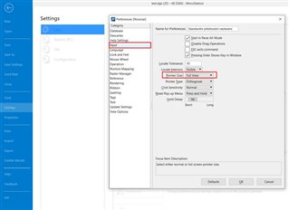

I would like to have the cross/pointer displayed over the entire drawing area. How can I set that?
Please go to:
File > Settings > User > Preferences > Input > Pointer Size > Full view
