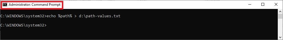

MicroStation - Text Window loads with a message "Error expanding variable MS_LIBRARY_PATH. Exiting." and closes MicroStation.
Other Bentley products may also display the following error.

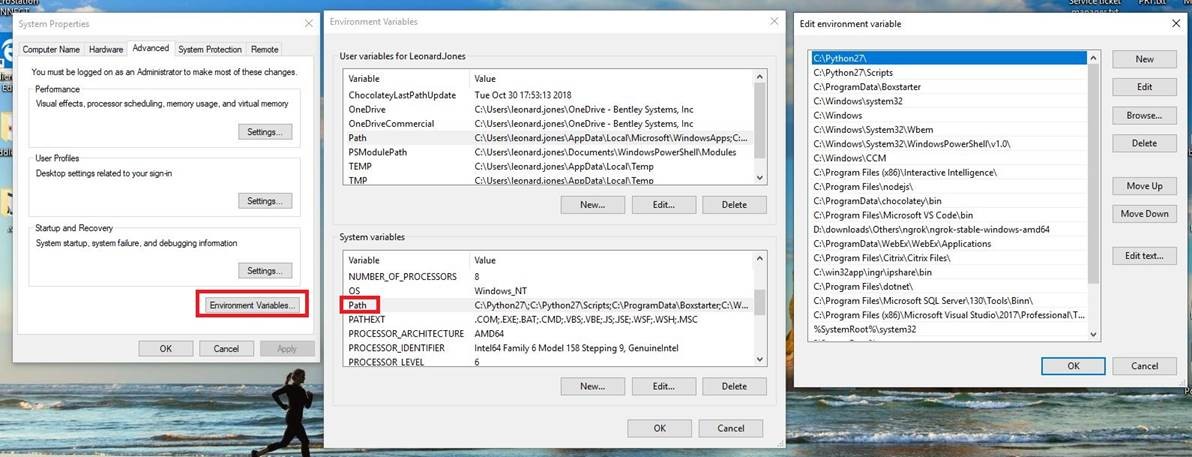

In most cases, where User’s reported this error, the problem was with PATH (system environment variable) values not set up correctly.
Try and expand PATH variable, look for any formatting errors and/or special characters.
You can also export the PATH values to a text file and look for errors.
•  Open CMD.exe as an Administrator
•  Key-in “echo %PATH% > d:\path-values.txt
If you require help, contact support team and provide the exported PATH values text file and MSDEBUG log of your workspace.
