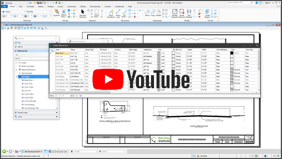

The following set of steps can be used to review your current set of resources:
    1. Open Explorer.
    2. Expand the Resources tab.
    3. Select the resource(s) that you wish to review.
    4. Right-click on this resource to display the right-click menu.
    5. From the right-click menu, pick Details.
    6. Set the display of the Details:
      • In the Details dialog, place the cursor in the upper left cell.
      • Right-click to open the right-click menu.
      • From the right-click menu, in Show Columns, enable/disable the display of the visible columns as desired (this can be easily done by clicking More). You may also reorder the column display.
      • Click OK.

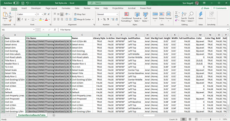

    7. Export the Details:
      • From the right-click menu, pick Export.
      • Set the Save as type to Excel Workbook (*.xlsx).
      • Type in the desired name for the Excel workbook.
      • Browse to the desired folder in which to save the file.
      • Click Save.
