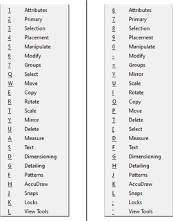

Another option for quickly accessing many of the most commonly used tools is through the “Quick Tools” menu. The keyboard shortcuts <Q> or <[> open the quick tools menu. This pop-up menu contains shortcuts to frequently used tools and ribbon group pop-ups. By having two shortcuts, the Quick Tools menu is easily available from the left or right side of the keyboard, helping accommodate left and right-handed users.
 (Left - Pop-up menu displayed when you press <Q> | Right - Pop-up menu displayed when you press <[>)
Once the Quick Tools menu is displayed, the desired tool or tool group may be selected by either pressing the associated character displayed next to the name or by clicking on the tool with the mouse.
For example, you can press <QE> to activate the Copy Element tool.

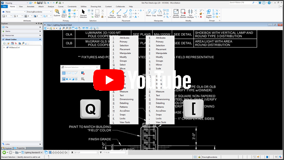

  1. Verify that the input focus is set to Home. This can be observed by looking for the “house” icon located on the status bar in the lower-right corner of the MicroStation application window. (see Illustration 1)
  2. Press the Quick Tools menu hot key (<Q> or <[>).
  3. Pick the desired tool or tool group.
