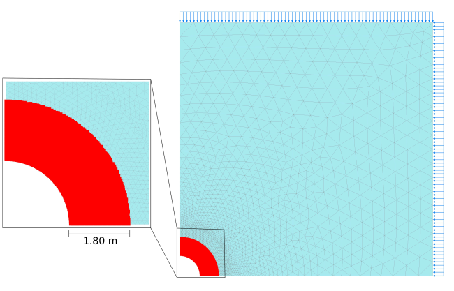

This document verifies that the Hoek-Brown model is correctly implemented in PLAXIS. For that purpose, the elasto-plastic behaviour of a rock mass is studied via a circular opening subjected to in situ stress in generalized Hoek-Brown material ( α ≥ 0.5 ). PLAXIS results are verified against the closed form solution presented by Carranza-Torres (2004).
Validation - Hoek-Brown material model - geometry
It is concluded that the results are in good agreement and the Hoek-Brown model is correctly implemented in PLAXIS.
