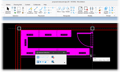

There is an easy solution to this problem. Simply use a tentative snap to identify the desired origin before copying the selected elements to the clipboard. When the selection is then pasted into the design, the origin used will be the location provided by the tentative snap!
Set the origin of the clipboard:
  1. Select the desired elements.
  2. Tentative snap to the desired origin location (but do NOT accept the snap point).
  3. Copy (or cut) the desired elements to the clipboard.
