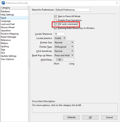

Exiting the current command can be done using the <ESC> key, but it must be enabled in User Preferences. To enable the <ESC> key to stop the current command, do the following:
  1. Click File to access the backstage.
  2. From Settings on the backstage, pick User > Preferences to open the Preferences dialog.
  3. In preferences select the Input category.
  4. Enable the preference ESC exits command.
  5. Click OK.
Preferences Dialog
Note: System Administrators and CADD Managers can set this for multiple users by adding this to a preconfigured set of User Preferences that are delivered through the configuration variable MS_USERPREFSEED. Note that the seed preferences are only used when a “local” user preference file does not exist such as at first use of MicroStation or if the user’s preference file has been deleted.
