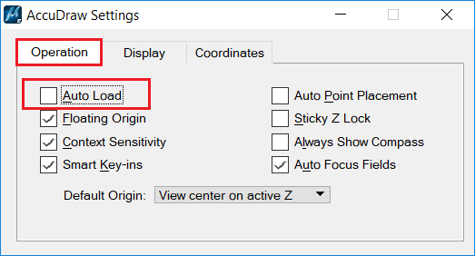

Follow these steps in MicroStation V8 / V8i (Select Series):
1. Go to Settings
2. Click AccuDraw
3. Go to the Operation tab
4. Uncheck Auto Load

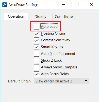

Follow these steps in MicroStation CONNECT Edition
1. Go to File > User > AccuDraw Settings
2. Go to the Operation tab
3. Uncheck Auto Load
