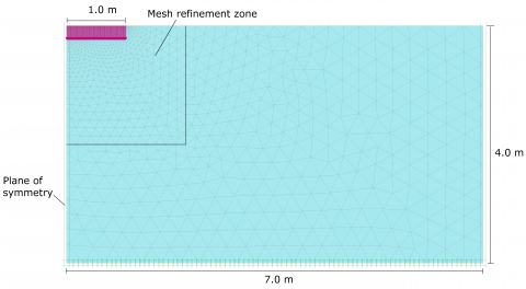

Smooth rigid strip footing on elastic soil
Application PLAXIS 2D
PLAXIS 3D
Version PLAXIS 2D
PLAXIS 3D
Date created 06 November 2012
Date modified 06 November 2012
This document describes an example that has been used to verify the elastic deformation capabilities of PLAXIS. The problem involves the settlement and stress distribution under a smooth rigid strip footing on elastic soil, according to Giroud (1972).
