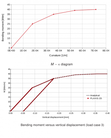

This document verifies that the non-linear deformation of plates is treated correctly in PLAXIS. An elastoplastic 'M - k' material type is used and the deformation of a cantilever under various loading conditions is studied.
