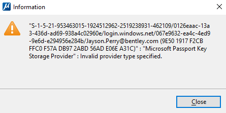

When adding a Digital Signature to a File or Model, an error message is encountered and the Digital Signature fails to attach.
"Microsoft Passport Key Storage Provider" : Invalid provider type specified
This error message indicates there is something wrong with the Certificate itself and it may not be valid.
Create a new certificate or use another valid certificate to resolve.
If the issue persists, it is recommended to consult with your organization's administrator for assistance.
