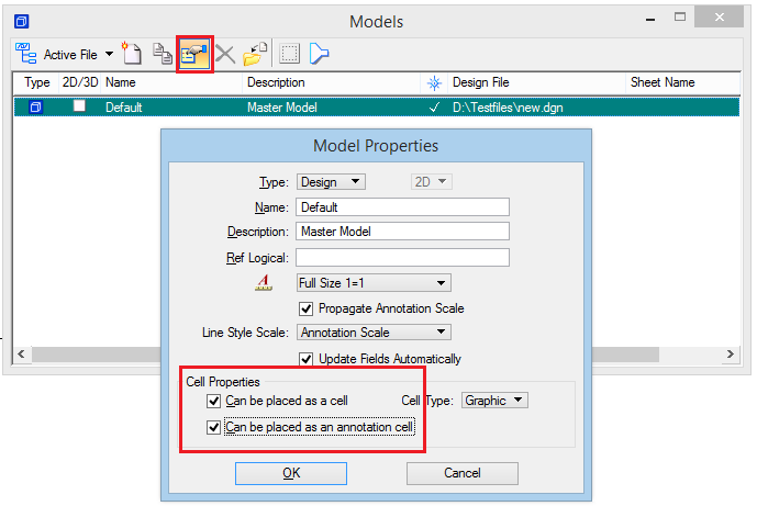

In V8i:
  1. Go to File > Models
  2. Select a model and click the Properties icon > Model Properties dialog opens
  3. There are two options, "Can be placed as a cell" and "Can be placed as an annotation cell".
    If both of these are checked the model can then be placed as a cell and as an annotation cell.
If the cell library is attached the cell will be marked as an annotation cell in the annotation column.

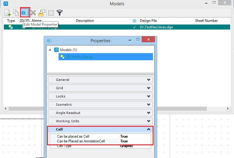

In Connect Edition:
  1. Drawing workflow > Home > Models
  3. Under the section Cell there are two options, "Can be placed as a cell" and "Can be placed as an annotation cell".
