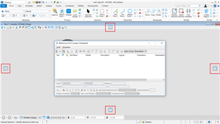

When you drag a dockable dialog, docking indicators appear on the screen. These docking indicators indicate which edges of the application window the selected dialog can be docked to. In most cases, a dockable dialog can only be docked either horizontally or vertically, however some dialogs can be docked both horizontally and vertically.
To Dock a Dockable dialog
- Select a dockable dialog's title bar.

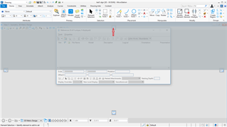

- Drag the dialog over one of the docking indicators that appears in the center of the screen or along the edges of the application window.
- Pause the pointer over one of the docking indicators. This highlights the available docking region along the corresponding edge of the application window.
- Release the mouse button. The dialog is docked within the selected docking region.

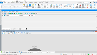

To Dock one Dockable dialog on Top of Another
- Dock a dockable dialog to an edge of the application window.
Dock another dockable dialog within the same docking region, so that the pointer is over the center docking indicator.
- Both dialogs are now docked on top of each other.
