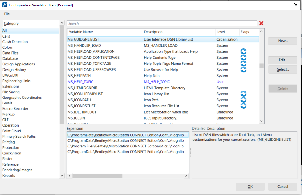

To configure the newly created dgnlib library, we can use the Configuration Variables dialog:
1. File > Settings > Configuration > Configuration Variables

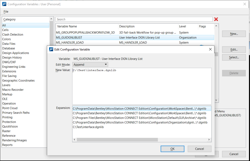

2. Select "MS_GUIDGNLIBLIST" from the list of variables and then click "Edit…"
3. Change the Edit mode to "Append" and type the path to the new dgnlib in "New Value". Press OK > OK again > Yes to save changes
4. Restart MicroStation to apply these changes, and open the newly created *.dgnlib file

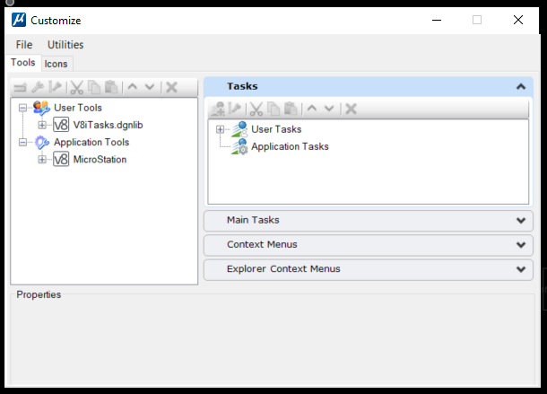

Now you should see the "User Tools" section in the "Customize" (File > Settings > Configuration > Customize) menu and should be able to make your changes to the interface.
Please note that by configuring the MS_GUIDGNLIBLIST variable from the Configuration Variables dialog, the change will only affect the currently active user within the Personal.ucf file.
If you want the .dgnlib to be configured for all users, the above variable needs to be manually defined in a configuration (.cfg) file such as Standards.cfg. This should be only done by the site administrator or by somebody who is familiar with MicroStation configurations.
