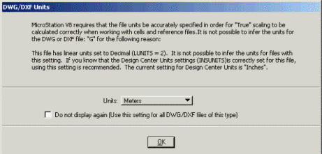

Alert Box for Unknown Units
An alert box is automatically displayed when a file is opened and the units are not known. There are three circumstances where the dialog will appear.
  1. The file is either Decimal, Fractional or Scientific and units other than Design Center have been selected. This would be the most common occurrence. It the units displayed are correct than you can simply hit OK. If you know that the units are correct for all files of this type, select the "Do Not Display" toggle to avoid seeing this alert box again.

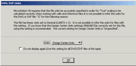

  2. Design center units have been selected, but are not available or unspecified in the selected file.

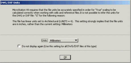

  3. The file is of type Architectural or Engineering and the units other than inches have been selected. This would only occur if the user explicitly changes the unit setting for Architectural and Engineering files to something other than inches.
