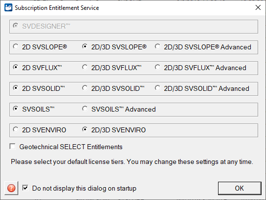

When SOILVISION CONNECT Edition Application is launched for the first time, it is recommended that users configure all license tiers to match their purchase. By selecting File > Subscription Entitlement Service, a window will open to select which SOILVISION license tiers will be used.

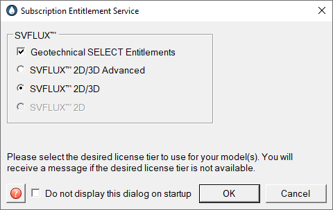

When opening a model, a module-specific Subscription Entitlement Service window will open, asking the user to specify what tier to use. The selected license tier should be set to match their purchase. Tier options may include some or all of the following:
The software will be enabled with features that correspond to this tier choice. Furthermore, the Geotechnical SELECT Entitlements option can also be included.
