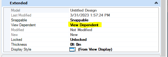

View Dependency of existing text can be changed using the Element
Information:
1. Select existing text nodes which need to be modified to "View
Independent" (or View Dependent")
2. Open Element Information and expand the "Extended" tab
3. Change "View Dependent" setting as required.
4. Close Element Information window
