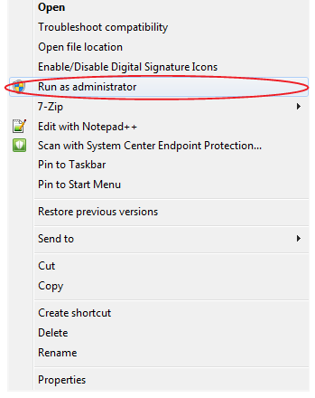

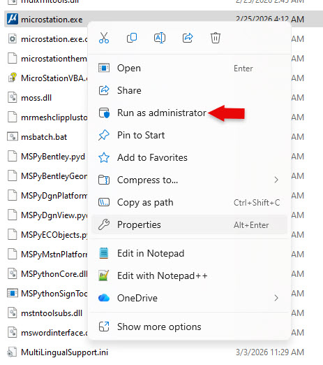

One easy step to identify if an issue could be caused by an installation without sufficient privileges is to try starting MicroStation "As Administrator".
Manually Start MicroStation As Administrator
1. Right click on MicroStation's shortcut
2. Select "Run As Administrator" from the context menu as shown in the picture below
If the unexpected behavior does not re-occur when the application is started "As Administrator", it may be necessary to uninstall and reinstall it following the steps in the following paragraph.

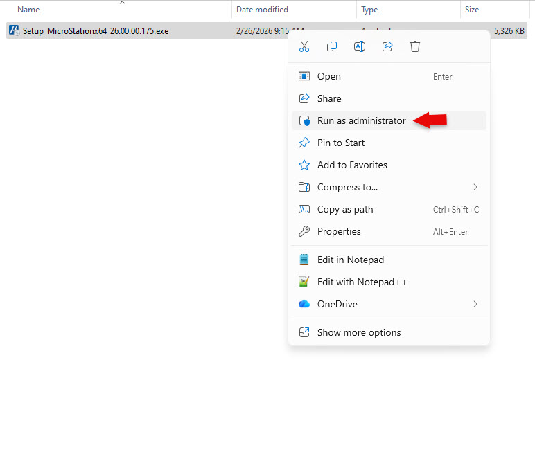

Set up MicroStation As Administrator
IMPORTANT: Make sure you have access to the correct MicroStation installation files before attempting the following procedure. In some environments it may be required to enter Administrator credentials when running an application "As Administrator". Make sure such credentials are available.
1. Uninstall MicroStation.
2. Locate MicroStation's setup file, either the downloaded setup executable (generally named after their version and language, e.g. Setup_MicroStationx64_26.00.00.175.exe for MicroStation 2026 English) or the "setup.exe if the self-extracting executable has already been decompressed (default folder e.g. C:\Bentley\Downloads\ms081109459en\)
2. Right click on "setup.exe" (or e.g. "Setup_MicroStationx64_26.00.00.175.exe")
3. Select "Run As Administrator" from the context menu as shown in the picture below
As mentioned above, MicroStation should always be installed and activated "As Administrator", even when the currently logged in user is part of the "Administrator" group.
Generally carrying out the "Product Activation Wizard" at the end of the setup, which has been run "As Administrator", will correctly activate the product.
Should there still be activation issues it may be required to uninstall and reinstall MicroStation "As Administrator".
