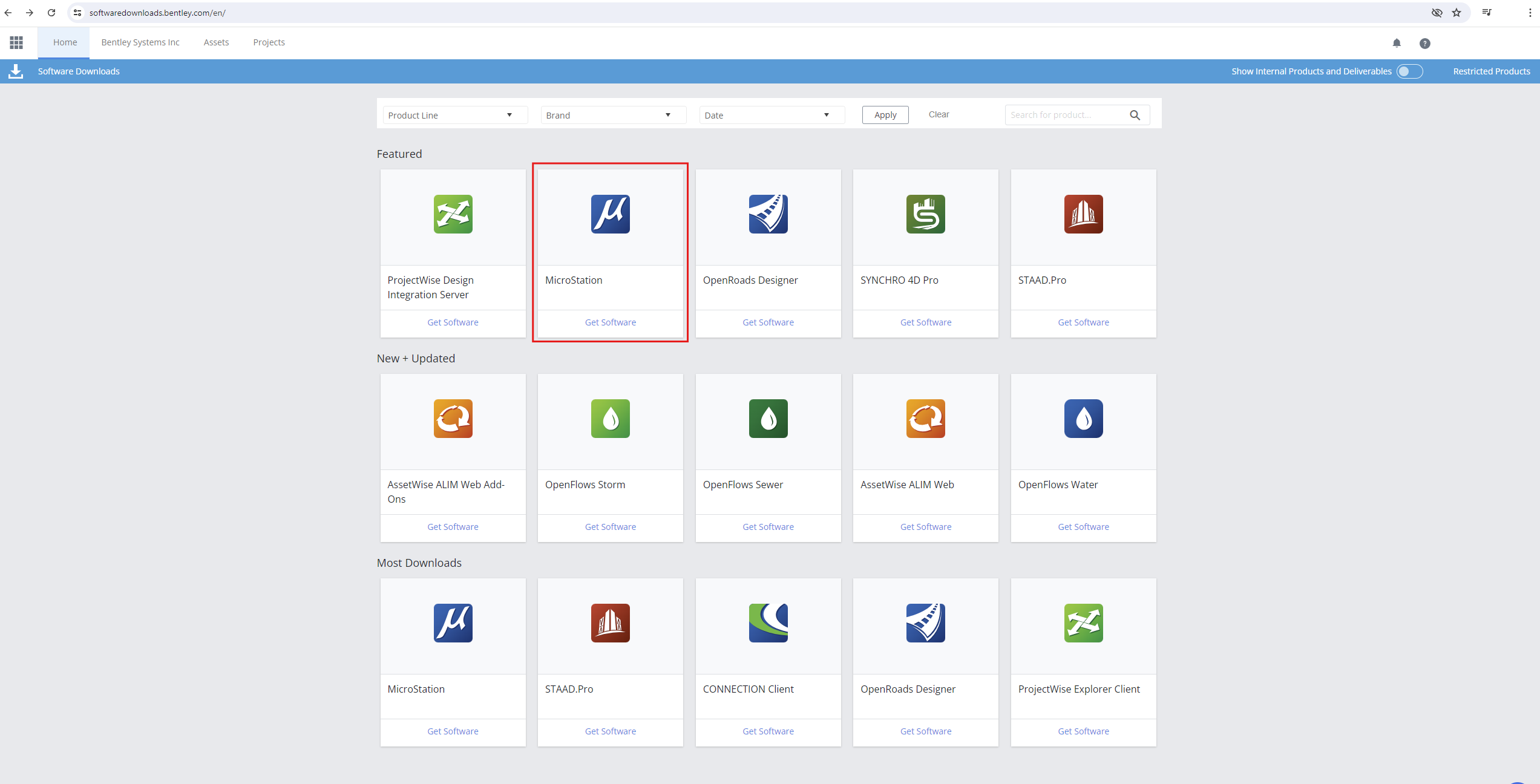

1. Open a web browser and navigate to https://softwaredownloads.bentley.com
2. Select MicroStation product

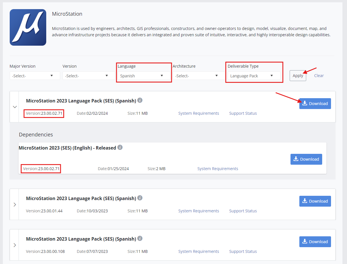

3. Run a search using the following filter in order to access language packs for a specific language:
Major Version: -Select-
Version: -Select-
Language: Spanish for example
Architecture: -Select-
Deliverable type: Language Pack
Select the appropriate Language Pack version according to the listed Dependencies. For example, if you have installed Microstation 2023 version 23.00.02.71, you need to install the same language pack version (23.00.02.71).
4. Once the installation file is downloaded, ensure that the specified version of MicroStation is already installed and then run the Language Pack .exe file to install the Language Pack

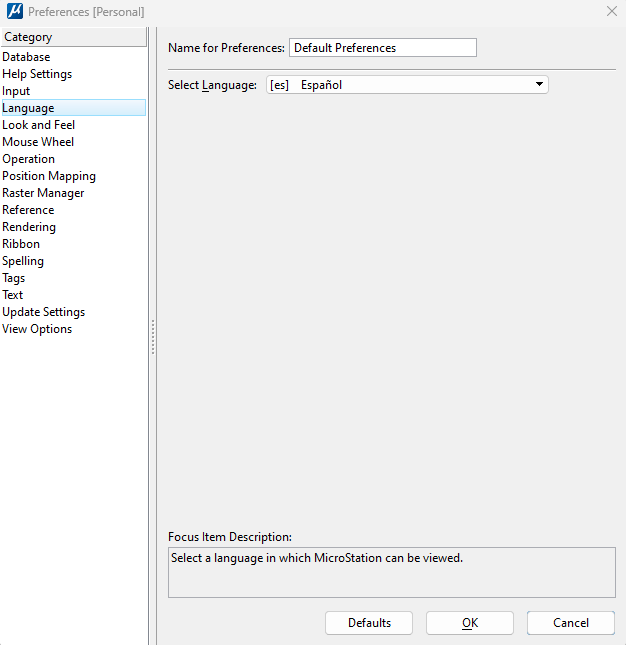

5. Once Language Pack is installed, launch MicroStation and open a drawing. The Language should automatically be changed to the new language contained within the Language Pack. If needed, navigate to File\Settings\User\Preference\Language Category and change from English to the other language available now (see below screen capture). Be sure to Save Settings (CTRL+f) to keep these changes.
Note - Every time you switch languages, MicroStation will need to be closed and reopened for the changes to take effect
