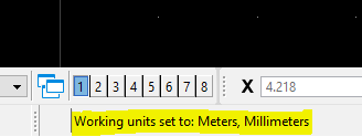

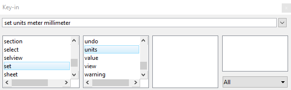

What is the syntax for changing the Working Units of my design files via key-in?
The syntax for this key-in is set units [master unit] [sub unit]
For example: set units meter millimeter would change your master units to Meters and your Sub Units to Millimeters.
Here are some things to keep in mind when using this key-in:
- Both [master unit] and [sub unit] should be the name of a known unit.
- Upper or lower case characters can be used.
- The unit syntax can be Singular or Plural (i.e. meter or meters)
- If only a master unit is defined, the sub-unit will be the same unit as the master unit
- Quotation marks are needed if the unit name has spaces in it. For example, set units "US Survey Feet" "US Survey Inches"
