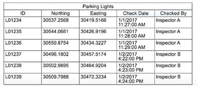

Is there an expression to get the X,Y coordinates of a cell. I'm attempting to generate a report with Y, X in its own entry in a table.
Following expressions can be used to get X,Y,Z coordinates of a cell.
this.GetElement().Origin.X
this.GetElement().Origin.Y
this.GetElement().Origin.Z
Cell properties like Cell Name, Origin are already stored as Element properties.
You need not, additionally store the above expression values as custom properties.
All of the Cell element properties are accessible in Reports feature.
Check this video to report on cell location.
Sample File: communities.bentley.com/.../Cells.dgn
