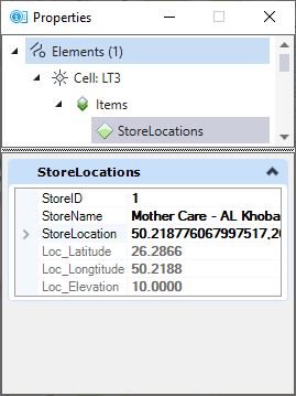

In the following expressions we are passing Cell Origin to extract Latitude, Longitude and Elevation values.
Coordinates.GCS.GetLatitude(this.GetElement().Origin)
Coordinates.GCS.GetLongitude(this.GetElement().Origin)
Coordinates.GCS.GetElevation(this.GetElement().Origin)
Following expressions can be used for Line, Point elements.
Coordinates.GCS.GetLatitude(this.GetElement().Segments[0].Start)
Coordinates.GCS.GetLongitude(this.GetElement().Segments[0].Start)
Coordinates.GCS.GetElevation(this.GetElement().Segments[0].Start)
