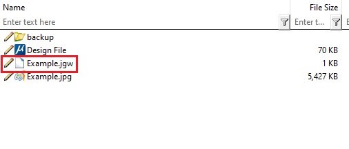

In MicroStation with ProjectWise integration, georeferenced raster images are not attaching to design files in the correct location. When MicroStation is not integrated with ProjectWise, the raster images attach in the correct location. How can the raster images attach correctly while MicroStation is integrated with ProjectWise?
Ensure the raster image's "sister files" (.jgw, .bmp, .hgr, etc.) are in the same ProjectWise directory as the raster image. If these accompanying files are missing, then the raster may attach in the incorrect location.
