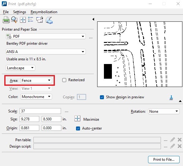

When creating a fence around design file elements and printing (File>Print), the print preview and the resulting print output file is not displaying the fence contents.
In the Print dialog, ensure the Area setting is set to Fence and the print output will print only the Fence contents. This setting will be grayed out if there is no active fence present.
Print Dialog Box
