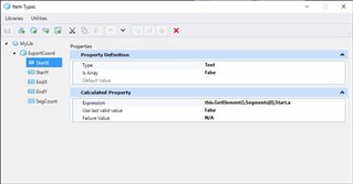

Request from User:
Can you please share Expression values to extract start, end coordinates of line elements
Following expressions can be used to extract the line coordinates
StartX     :  this.GetElement().Segments[0].Start.X
StartY     :  this.GetElement().Segments[0].Start.Y
EndX      :  this.GetElement().Segments[this.GetElement().Count-1].End.X
EndY      :  this.GetElement().Segments[this.GetElement().Count-1].End.Y
