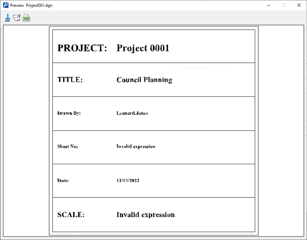

Named Expression for Text Substitution displays as Invalid Expression
 Product(s):MicroStation
 Version(s):10.17.01.62
 Environment:N\A
 Area:Properties
 Subarea:Named Expressions
Configuration variable MS_DGNLIBLIST was set to file “NamedExp.dgnlib”
In MicroStation CONNECT, configuration variable MS_GUIDGNLIBLIST should point to the Named expression DGNLIB file.
MS_GUIDGNLIBLIST > D:/Support_PDFs/TestCases/NamedExpression/NamedExp.dgnlib
Using Named Expressions to drive interface items
