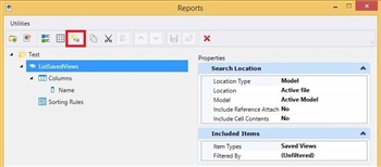

Request from User:
Does anybody know a simple way of exporting a list of saved views present in a design file to simple .csv format or similar?
This can be achieved through Reports feature in MicroStation Connect.
•  Create a report definition “ListSavedViews” and include Items "SavedViews"

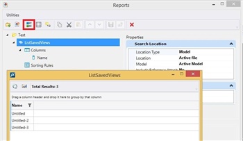

•  Add the required columns to report and Preview result

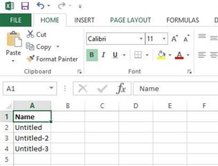

•  Export results
•  Sample Excel Report
