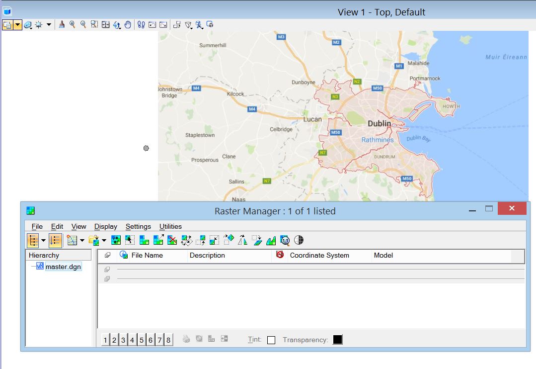

The attached raster file is not displayed in the Raster Manager list box, however the raster is displayed in the model. Why it is not listed in the Raster Manager, although in the title there is 1 of 1 listed?

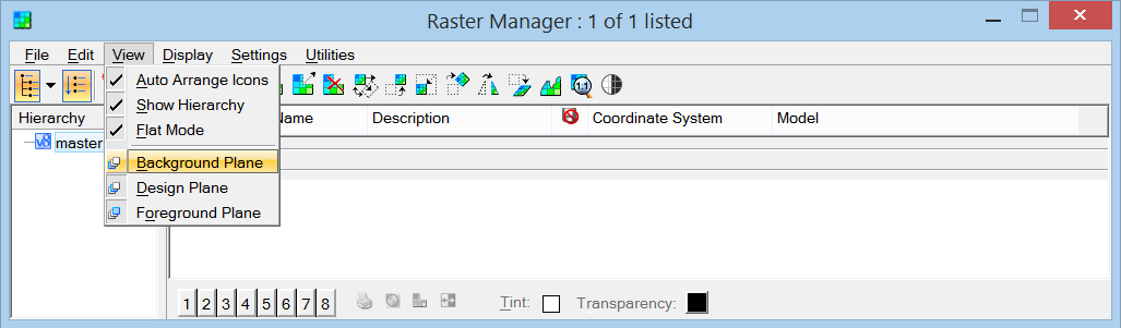

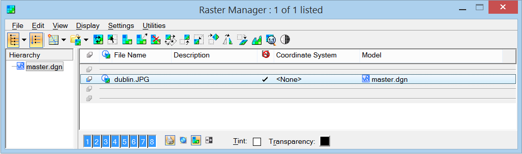

In the Raster Manager turn on View > Background Plane and the image(s) in the background plane will be displayed in the list box.
