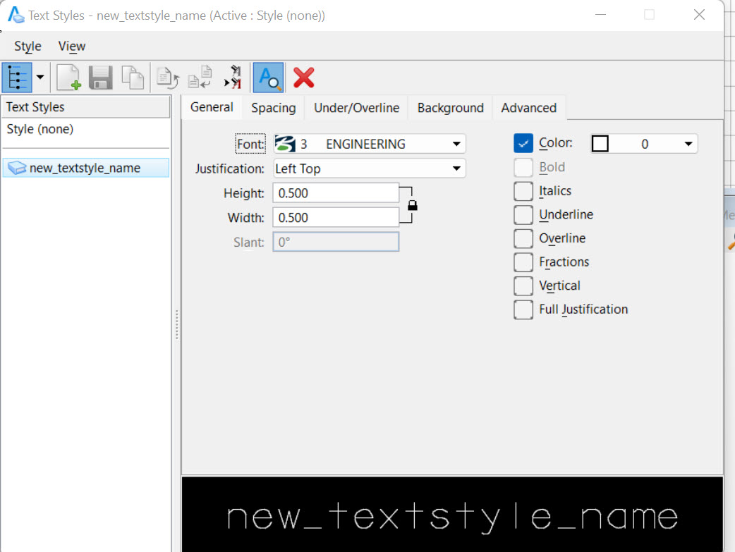

What is the correct syntax order for Key-In "textstyle rename"?
Correct Key-In syntax order for the "textstyle rename" command:
textstyle rename "new_textstyle_name" "old_textstyle_name"
where:
"new_textstyle_name" - new text style name (after the change)
"old_textstyle_name" - the original, existing name of the text style (before the change)
Before:
After:
