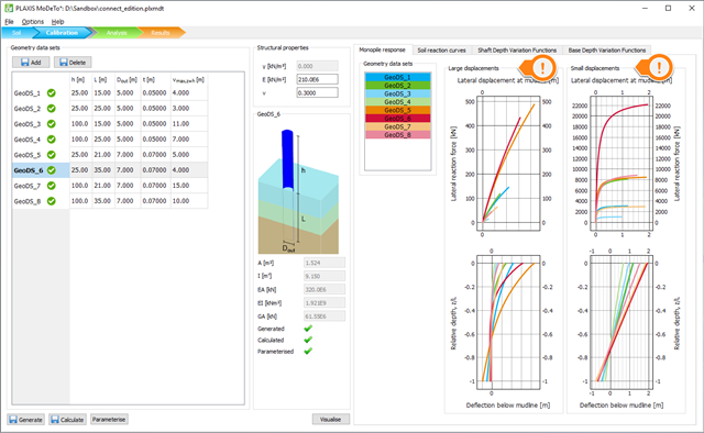

In the Calibration tab, monopile response section, four curves are shown. Here, in PLAXIS MoDeTo CONNECT Edition V20 (release of January 2020) the 'Small displacements' charts are labelled 'Large displacements' and vice versa.
This is now resolved in PLAXIS MoDeTo CONNECT Edition V20 Update 2.
For older versions, this switch should be apparent by the numerical values displayed. Note that the descriptions in the Manual are correct.
