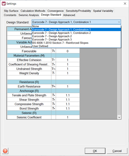

To apply a Eurocode 7 approach in SVSlope, open the Model > Settings dialogue, and select the Design Standard tab, then select the Design Standard you would like to apply. The default Design Standard selection is None. The following pre-defined options are available:
Figure 1: Set Eurocode 7 Design Standards.
After the user selects the pre-defined design approach, the corresponding partial factors will be shown on the same page. The user cannot edit the partial factor values for the pre-defined standards. If the user wants to define their own partial factors, select User Defined option, then the user can edit the values on the Partial Factor column.

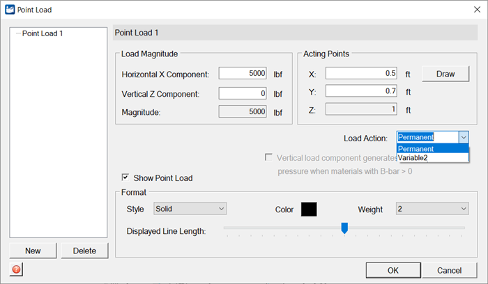

After the user selects a design approach, the user may need to set Load Action as Permanent or Variable if there are external loads in their model. For 2D models, it is shown as in Figure 2 for Distributed Load. For 3D models, it is shown in Figure 3 for Point Loads.
Figure 2: Set Load Action for 2D Distributed Load with a Eurocode 7 design approach selected.
Figure 3: Set Load Action for 3D Point Load with a Eurocode 7 design approach selected.
