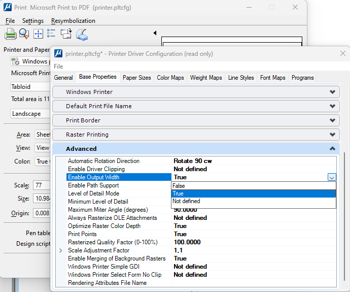

Line width defined in Pen Table not displayed in the print dialog and also not printed correctly on
 Product:MicroStation
 Version:All
 Environment:N\A
 Area:Print/Plot
 Subarea:N\A
Line width, defined in a MicroStation V8i Pen Table, are not displayed in the print dialog and also not printed correctly on a HP Design Jet T770 printer using the Bentley printer.pltcfg driver.
Line width defined in a Design Script are previewed and printed without problems.
Configure the print.pltcfg driver as follows;
-> Base Properties -> Advanced -> Enable Output Width = True
