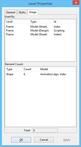

  2. Select specific level and do right click
  3. Select properties
  4. Select Usage tab
If any share cell is defined

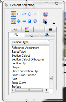

5. Select Element Selection\Element type and select shared cell
6. Use Drop Element using the option shared cells to normal cell

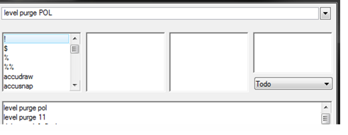

7. Purge all empty levels with defined shared cells using key in: Level purge Levelname
             Example (key in: Level purge POL).

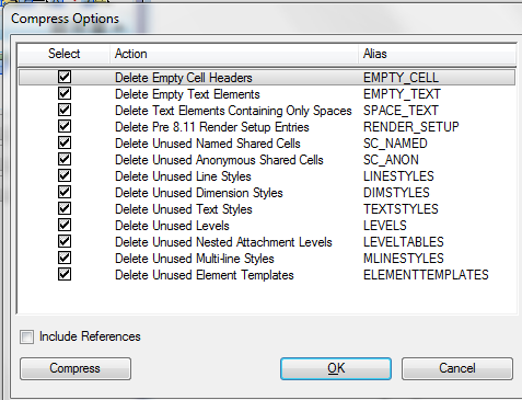

8. Compress file from File \Compress\Options and save changes
Compress Options
