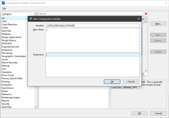

Set the value of the configuration variable: _USTN_DISPLAYALLCFGVARS
  1. Go to File > Settings > Configuration > Configuration Variables.
  2. In the Configuration Variables dialog, click New.
  3. In the Variable field, enter _USTN_DISPLAYALLCFGVARS.
  4. In the New Value field, enter 1.
  5. Click OK.
  6. An Alert dialog is displayed, stating the current value of this variable. Click OK.
  7. In the Configuration dialog, click OK.
  8. Again, an Alert dialog is displayed. Click Yes to save changes to the configuration file, closing the Configuration Variables dialog.
When you return to the Configuration Variables dialog, you will see many additional configuration variables displayed that start with "_...". These are the hidden configuration variables.
