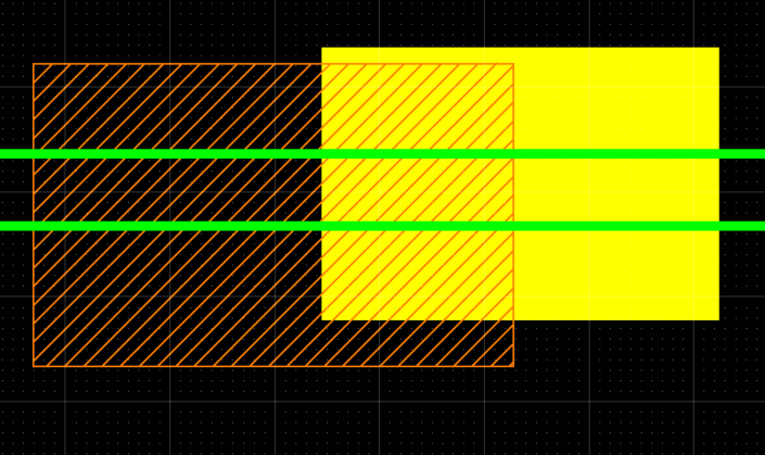

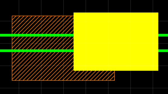

Elements in a 2D model are displayed based on draw order by default. If you place elements in a 2D model on top of one another, the element that was placed last will have display priority.
If you want to change the display order of elements, there are several ways to do this.
Recommendations
As an example, here are some some elements as drawn in a 2D model.

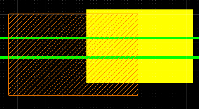

Option One - Bring to Front Tool
Select an element (in this case, the patterned element) and use the Bring to Front tool (Home Tab > Selection Ribbon Group > Bring to Front)
The selected element (patterned element) is now displayed on top

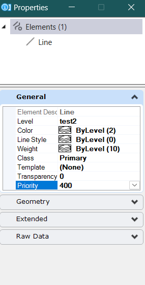

Option Two - Set Priority within Element Properties
Select an element (e.g. a single green line), select Properties, & look for the Priority property.
Set a priority specifically for that one element. Elements with higher Priority values will display on top of elements with lower priority values (default value is 0).
The Green Line with the higher priority value is now displayed on top of the other elements.

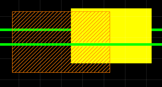

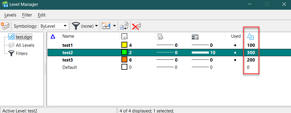

Option Three - Use Level Manager to Set Level Priority
In the Level Manager, setting a Level's Priority will change the entire level's display order.
All existing and new elements drawn on the level will be changed, but keep in mind, this will not change the indvidiual element Priority setting contained within the Properties dialog.
As you can see, the elements will now follow the Priority values that have been set in the Level Manager

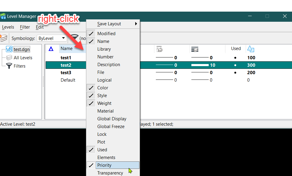

***NOTE***
You will need to make sure the Level Priority column is turned on within the Level Manager.
Right-click the column headers >toggle ON Priority
