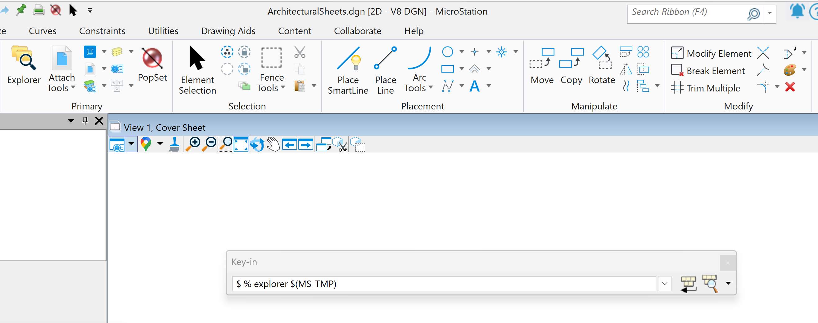

Option 1: Locating the ExceptionHistory folder from Microstation key-in dialog
1. Start MicroStation (if it can be started by opening at least one design file, otherwise go to Option 2)
2. Open MicroStation’s Key-in panel and type the following string: $ % explorer $(MS_TMP)

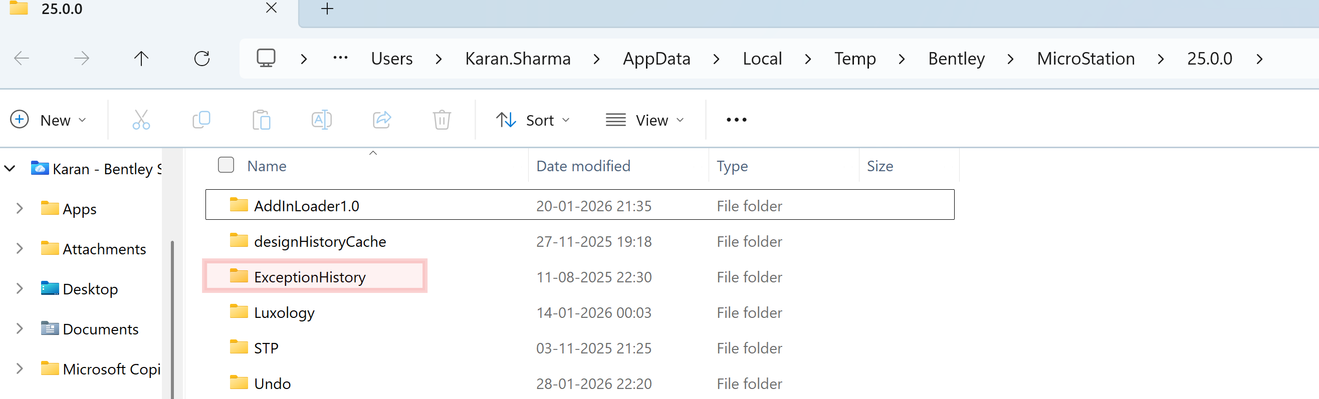

This will open your temp folder in Windows Explorer, where the ExceptionHistory is located by default

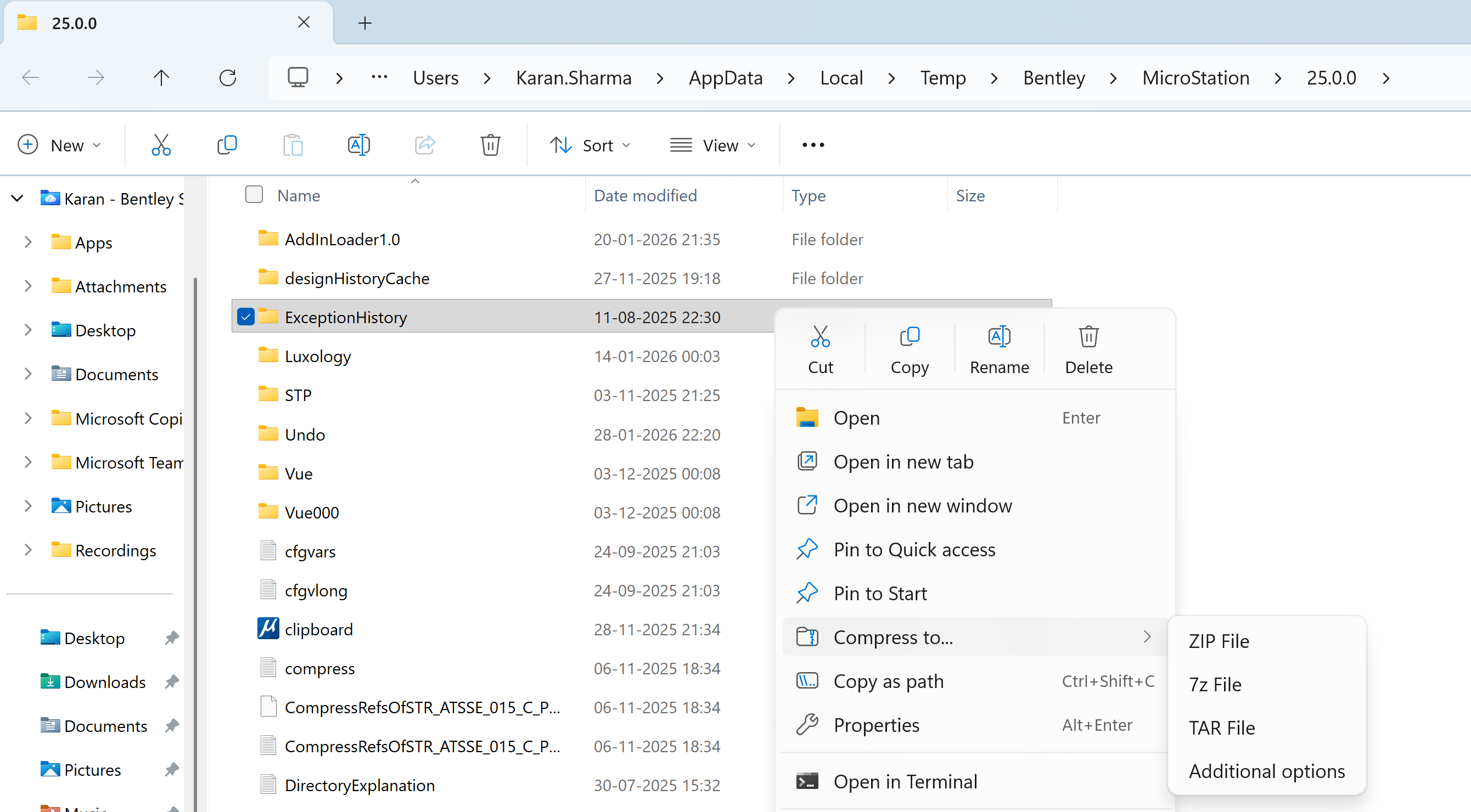

Once you have found the "ExceptionHistory" folder, you can now zip the contents of this folder into a compressed zipped folder (.zip) and send to Bentley Global Technical Support for further review.

MicroStation CONNECT Edition
C:\Users\{UserName}\AppData\Local\Temp\Bentley\MicroStation\10.0.0\ExceptionHistory\
MicroStation 2023 onwards
C:\Users\<username>\AppData\Local\Temp\Bentley\MicroStation\2x.00.xx\ExceptionHistory\
