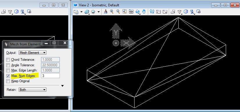

Converted mesh models appear to be unchanged.--When a rectangular shape or a slab is placed in to a design file and it is created into a mesh element, why does the solid or shape appear to be unchanged and does not show a triangulated mesh?
This happens when the maximum number of edges exceeds the value of 3. If the number of edges is set to the minimum of 3, each rectangle or side of the slab will be represented as two triangles.
