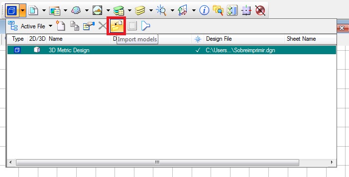

- Another option we could do is create a new blank DGN file and from there as it is shown on the attached screenshot we can import the model we are interested in.
