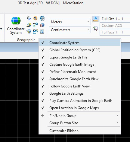

Here you see the list of tools from MicroStation CONNECT Edition Update 17.2

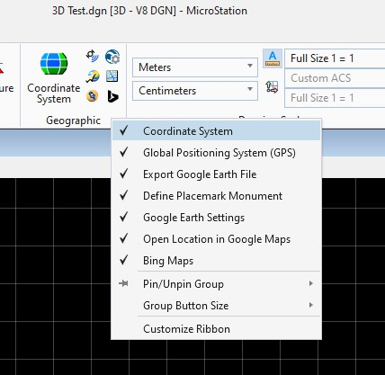

Here is the list of tools from MicroStation 2023.

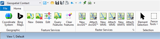

There is also a whole new ribbon dedicated to geospatial context integration. Click here for more details.
