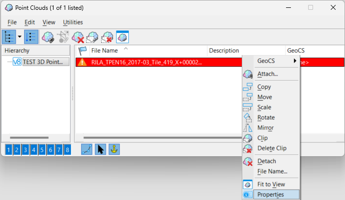

But this time when trying to detach the point clouds, MicroStation's Message Center responds with "No elements found"
Open the Point Clouds tool and select the point cloud(s) showing in red.

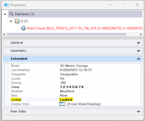

Use a right mouse click to open the options menu (see below) and select the Element Properties tool.
In the Extended section, Locked, change the label to Unlocked (see below)
This will unlock all selected point clouds and now they can be detached

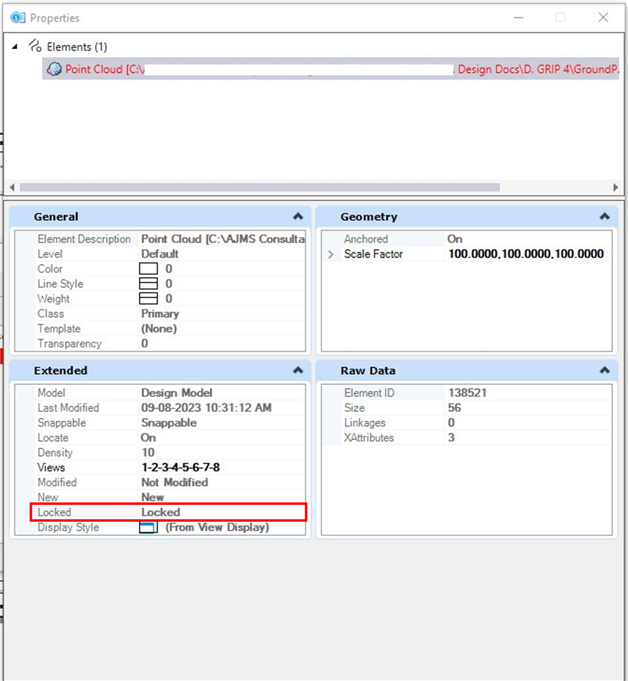

If the Locked option is greyed out (see below) the reason could be that the point cloud is part of a reference attached to the project.
In this case, it is necessary to select the file that includes the Point Cloud from the References menu->Right click on it-> select "Exchange" option.
Open the Point Cloud menu-> select the Point Cloud-> select "Detach" command.
