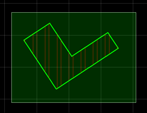

Place a fence around the desired elements.

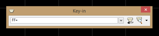

Open Key-In Dialog Box, Type in “Fence File” or “FF=”
Hit the Enter Button

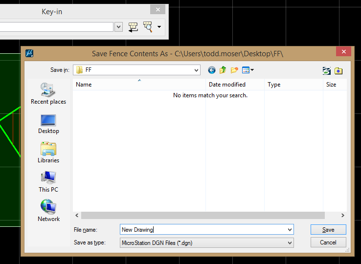

This will open a Windows Explore Dialog Box. Browse to where you want to Save the New File and Name your New File. Save this File.
You will be prompted to Accept the Contents. Click a Data Point on the Screen to Save the elements to the New File.
You will see the File has been Saved to the new location and name.
