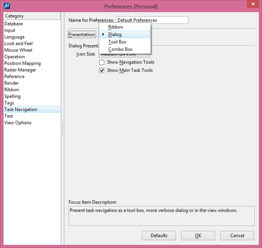

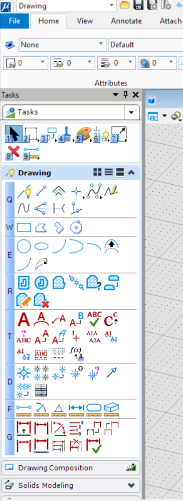

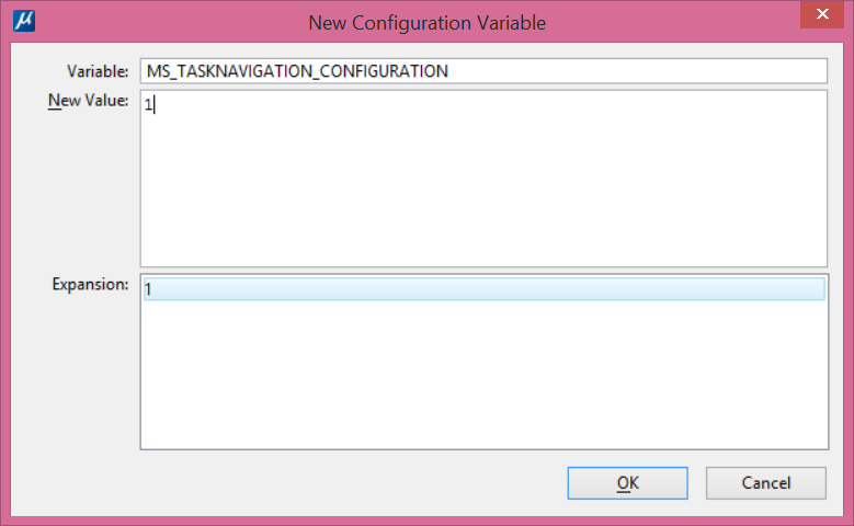

How to display the V8i style Tasks dialog in MicroStation CONNECT Edition through Update 12 (version 10.12.00.40)?
