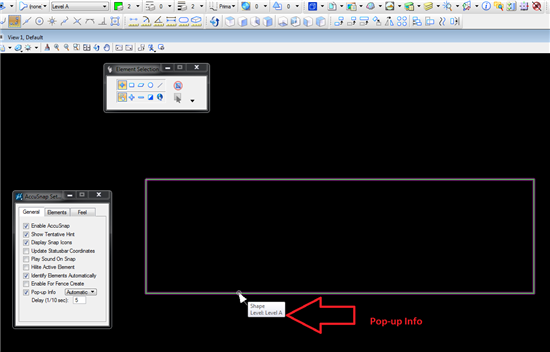

How to turn on or off the Pop-up Info that appears when hovering the mouse over an element
When hovering the mouse over elements, the Pop-up Info appears to display information about the element, such as Element Type and Level (see image below)
Pop-up Info can be enabled or disabled through AccuSnap Settings.

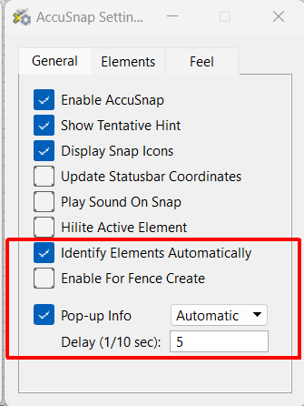

Please note that the setting “Identify Elements Automatically” needs to be enabled as well to get the pop up info displayed; so both settings need to be enabled at the same time as shown below:
