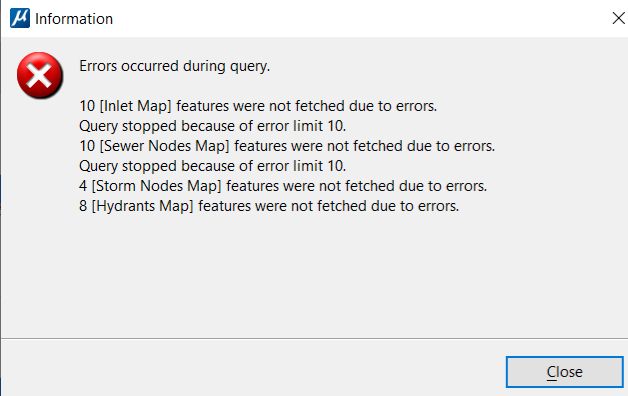

When using the Query Features tool Information dialog appears "Errors occurred during query. ..featu
 Product:MicroStation
 Version:2023
 Environment:N\A
 Area:Geospatial Context
 Subarea:Feature Services
When using the Geospatial Context Workflows Feature Services 'Query Features' tool user receives the following Information dialog:
In this instance the MicroStation user did not have write permission to the folder pointed to by the variable _USTN_OUT set by their Site Administrator.
Option 1
Have your Site Administrator grant Write access to the folder pointed to by the variable _USTN_OUT
Option 2
Have your Site Administrator change the folder pointed to by the variable _USTN_OUT to a location where user(s) have write permission
