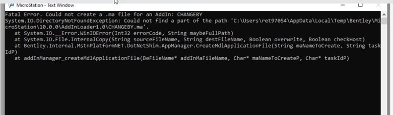

MicroStation and related Bentley design products may intermittently fail to start or stop while running.  The cause is that some external process has deleted the AddInLoader1.0 folder required by Bentley desktop products.
A typical failure would be:
It could affect any PowerPlatform based product.

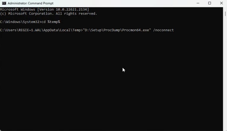

  3. Run Command Prompt in administrator mode
  4. Type in    cd %temp%
    to change prompt to temporary folder.  This will help prevent you from unintended changes.
  5. Run Process Monitor from the path were the download .ZIP was expanded. The default is the current user’s download directory.
Run Process Monitor
  %USERPROFILE%\Downloads\ProcessMonitor\Procmon64.exe   /noconnect

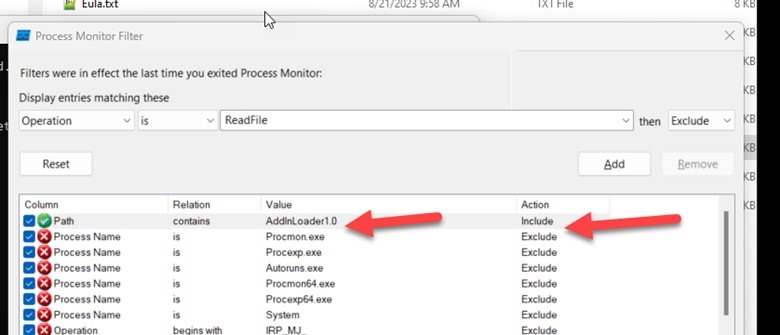

       6. The next steps add in filters to collect only those operation involving the folder path “AddInLoader1.0
         Add filter:
  1. In the first option box change Operation to Path
  2. In the second option box change is to contains
  3. In the third option box type in AddInLoader1.0
  4. In the fourth option box select Include
  5. Click the Add button

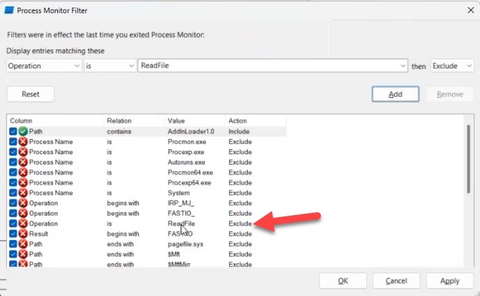

  1. Filter out other operations that are not needed for this analysis.
    Add filter:
    1. In the first option box change “Operation” to “ReadFile”
    2. In the second option box change “is” to “contains”
    3. In the third option box type in “AddInLoader1.0” (do not enter the quotes)
    4. In the fourth option box select “Exclude”

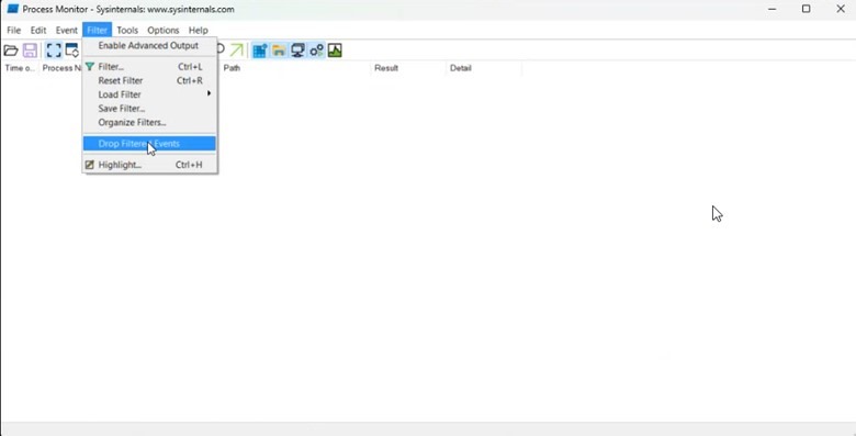

  1. Drop Filtered Events

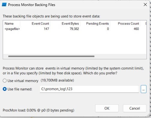

  1. Create Saved File, Go to File>Backing Files…
  1. Choose a location and file name. I recommend a path like
        %temp%\Procmon-logs\CS0061200_2023-08-22_A
    where the tail of the path is replaced by your service case number followed by today’s date for uniqueness. The “_A” suffix can be used to distinguish multiple data collection cycles within a day.

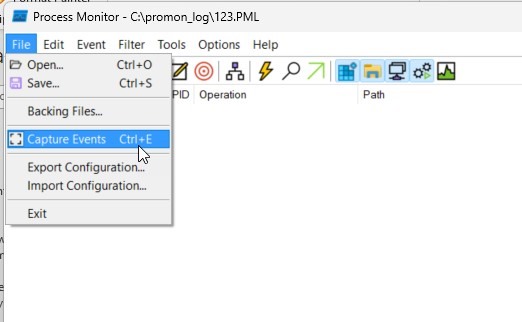

  2. Capture Events
Allow ProcMon to run in the background until error occurs again.  You can minimize the ProcMon window.
Once error has occurred go to ProcMon’s File>Save and save a .pml file. Please send that file to your Bentley support representative.  You can compress the file to reduce storage space and transmission time.
