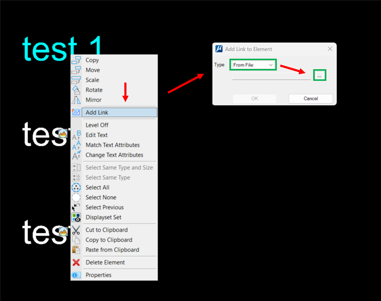

2 - Attach the saved view:
Right-click on the wording/element where the saved view need to be assigned->Add link.

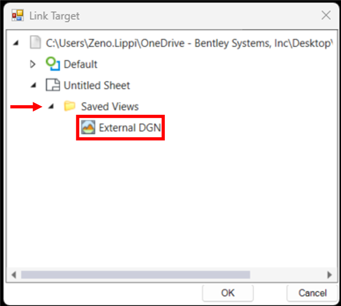

From the displayed window, select 'From File' as the Type and by clicking on the three dots icon  select the file where the saved view is located.
Expand the drop-down menu of the model that includes the saved view-> Select saved view -> OK.

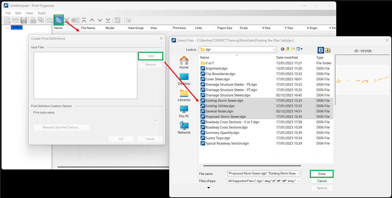

3 - PDF creation via Print Organiser:

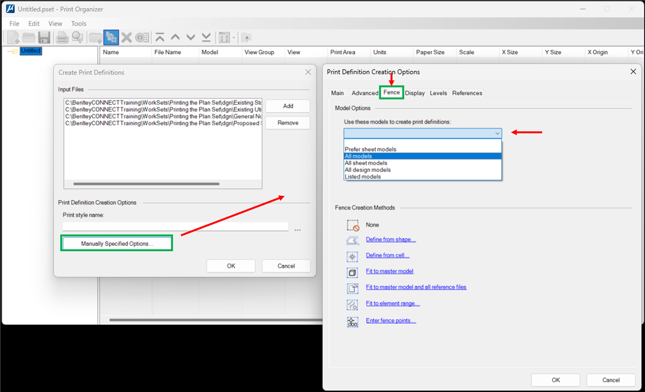

Open the Print Organiser-> Add Files to Set-> Select all files involved in the links-> Add

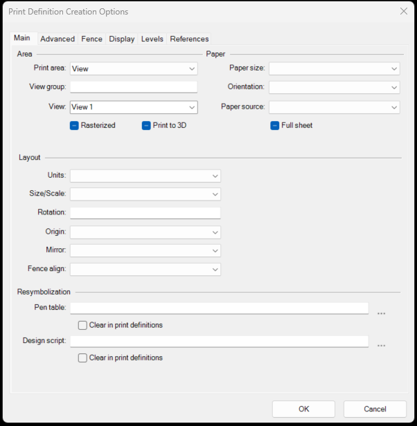

Select the "Manually Specified Options" command from the Create Print Definitions window. From the "Fence" tab, select the "All Models" option from the drop-down menu to include all Models in the PDF printout.
 Define the print area and view from the 'Main' tab and press OK
