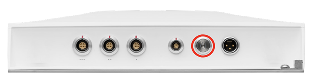

The X3 Series THREAD has a multicolor LED behind the power button that provides a diagnostic indication of its current state. The reference guide below will assist the user in determining the current state of the Thread.

Color Spectrum LED: Boot up
Indicates boot process from cold start or sleep mode. This process lasts approximately 120 seconds.
CROSS-COLOR SPECTRUM MODULATION
Green LED: Connected
THREAD is active and operating in high-power mode and IS connected to the cloud.
GREEN FLASH, 3 SECOND FREQUENCY
Red LED: Disconnected
THREAD is active and operating in high-power mode and IS NOT connected to the cloud.
RED FLASH, 3 SECOND FREQUENCY
Blue LED: Low power mode
THREAD is in low-power mode to conserve battery and will wake at the next scheduled time.
BLUE FLASH, 10 SECOND FREQUENCY
Yellow LED: Battery below lower limit
Thread is in low-power mode to conserve battery and will wake once input power is restored and the battery exceeds the low voltage cutoff threshold.
YELLOW FLASH, 10 SECOND FREQUENCY
Note: Any other LED colors being observed from the THREAD should be noted and contact support by creating a ticket at support.infrastructureiot.com as this is unusual and unwanted behavior.
