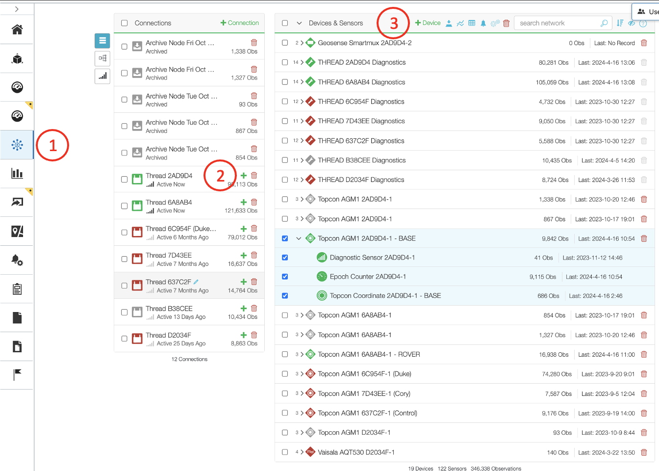

1. Navigate to the Connectivity Module.
2.  Press the  button directly on a THREAD to add a Device to it. If your THREAD does not appear here, you may still need to Add Your THREAD as a Connection.
3.  You may also add a device from the  button in the Devices & Sensors Section.

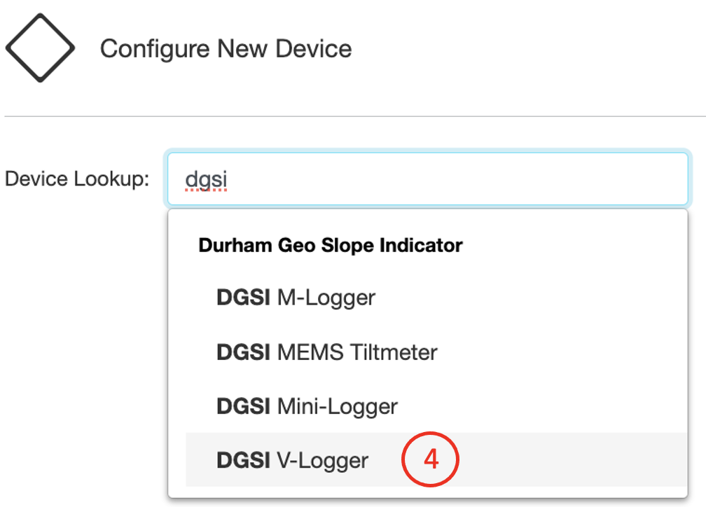

4.  Begin by typing in "DGSI V-Logger" and select the name once it autocompletes in the search box.

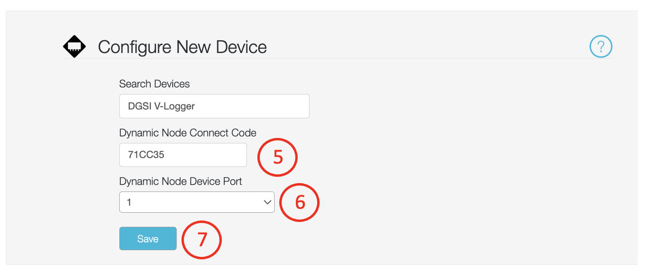

5.  If not already populated, type in the Connect Code of the THREAD that the Device is plugged into. The Thread Connect Code will be pre-configured if the button on the THREAD was used in Step 2.
6.  Next, select the THREAD communication port that the device is plugged into, Device 1, 2, or 3.
7.  Press     to write the settings and finalize the Device addition.

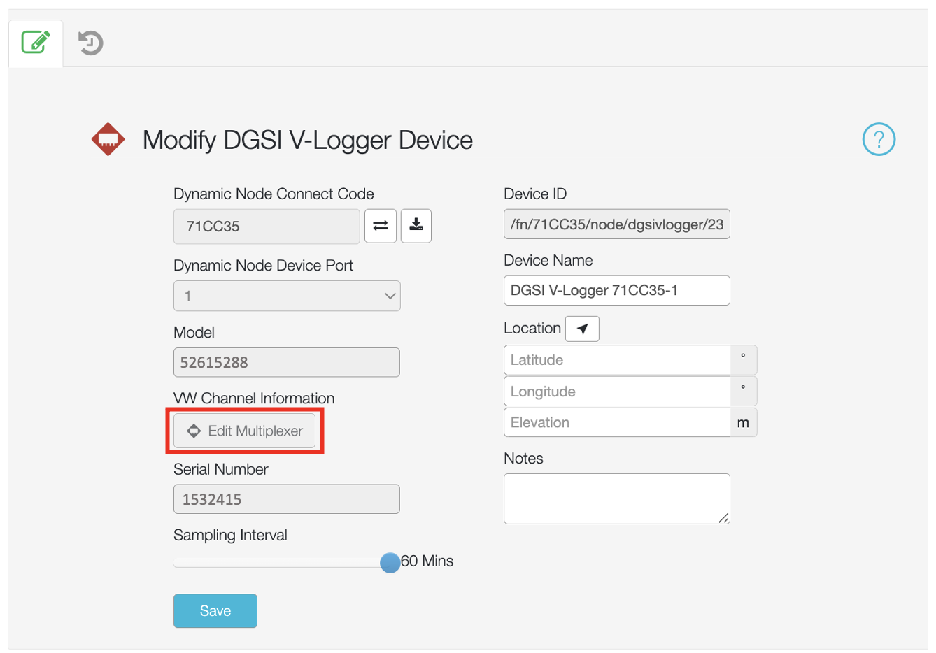

iTwin IoT will automatically detect the V-logger connected and will bring in serial number, number of channels, and model number in the following page.
MUX Configuration
The Vibrating Wire Channels on the Datalogger will now need to be configured to the specific VW you are using for a sensor to be created within iTwin IoT and the channel to read the VW sensor. Click the "Edit Multiplexer" button under VW Mux Information.
If you have exited the device configuration page below, click back into the DGSI V-logger by finding it in the Devices & Sensors list on the right-hand side of the Connectivity page. This will open the Device configuration settings again.
After clicking the "Edit Multiplexer" button, the screen below will appear. Select the type of vibrating wire that is on each channel and the suggested Frequency Sweep will be automatically filled in.
Click "Done" when finished, and make sure to click "Save" to write the settings.
Once saved, the configured vibrating wire sensors will populate beneath the DGSI V-Logger Device and can be viewed by clicking the drop down arrow.
