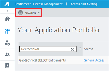

Geotechnical SELECT Entitlements require a separate license activation at the start of using the software. However, that license is provided free of charge to any account that has an active SELECT subscription for the period of that SELECT subscription, or a current Virtuoso practitioner license. Administrators can find the Geotechnical SELECT Entitlements license listed under "Global" entitlements on the Entitlement/License Management page:
Geotechnical Select Entitlements is listed under Global entitlements
