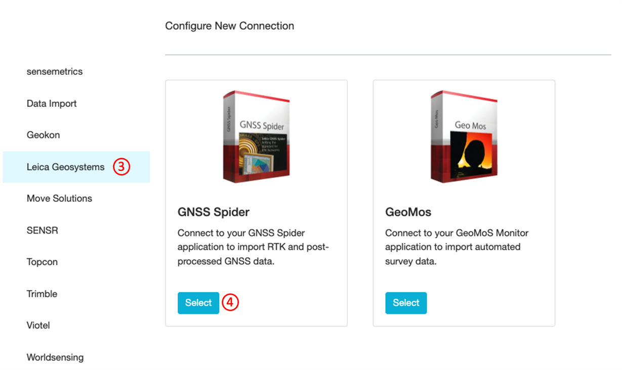

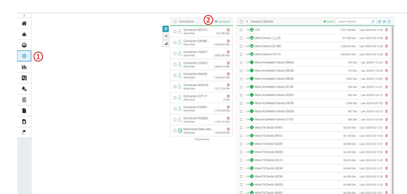

1. Select the Connections tab on the lefthand side of the page.
2. Go to the Connectivity Page and click the   button.
3. Select Leica Geosystems on the lefthand column.
4. Click the   button under the GNSS Spider option.

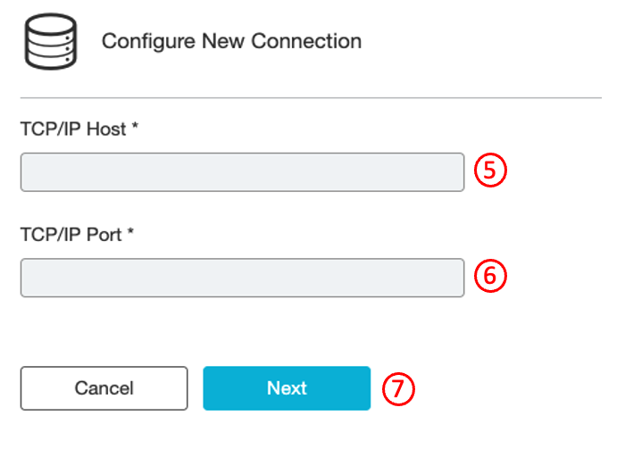

5. Enter the TCP/IP Host of the Spider Server, this will be the external IP address of the Windows machine that's running Spider
6. Enter the TCP/IP Port of the Spider Server, default is 1433.

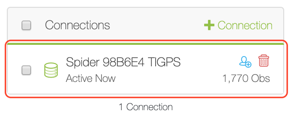

7. Click Save, the Spider Server will now be added to your organization.

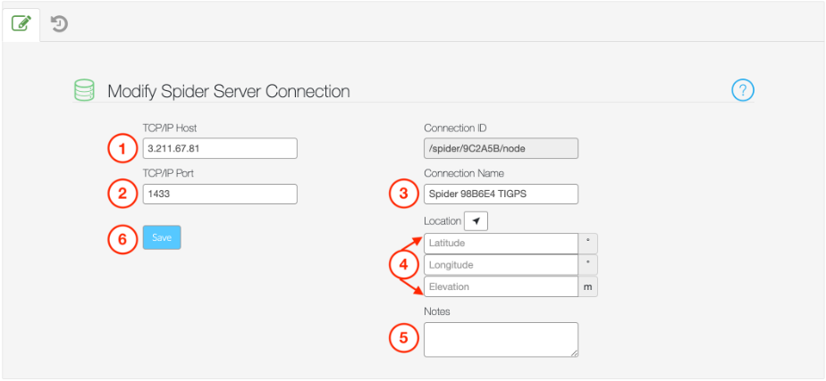

To make modifications to your Spider connection, click back into the Spider Connection from the Connections configuration page (see below).
Once in the configuration page, several fields can be modified.
1. The TCP/IP Host can be changed if the Spider server IP changes or if it was entered incorrectly to start.
2. The TCP/IP Port can be changed although this will be a very rare occurrence.
3. Here the name of the Spider connection can be modified.
4. Here users can modify the location of the Spider server. This will not affect the location of any of the AMTS or associated prisms.
45. Here users can add in notes related to the Spider connection.
6. Click   to save the changes made to the Spider connection.
